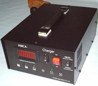

encontrei um carregador de 30 amp,so que e uns 400 euros
model:
hwc4-72v/30a
lead time is 5-7 business days.
please note your battery type. is it lead-acid liquid battery (may add liquid to the battery periodically), or maintenace-free battery
dimensions: 290mm(l)*215mm(w)*110mm(h)
input voltage: ac 220v 50/60hz
max input current: 14a
max output current: 30a
battery voltage: 72v
charge mode: six segments type.
charge time: 6-12 hours
output power: 2.16kw
operating temperature: -10c - +40c
humidity: less than 80%
support battery: "lead-acid liquid batteries" or "no maintenance batteries".
description :
1. output short protection
2. battery reversed connect protection
3. system over temperature protection
4. automatically turn off when battery is full.
5. time turn off
6. charge automatically when the voltage down
7. battery auto-detect
8. the charge process shown by led;
9. the charge process controlled by cpu
used in electric golf car, car, police car, portage truck, tourist car, boat, dragged car and etc.

pois, mas carregar baterias chumbada em 1 hora dar-lhe a sentença de morte para algumas semanas ou até meses.
